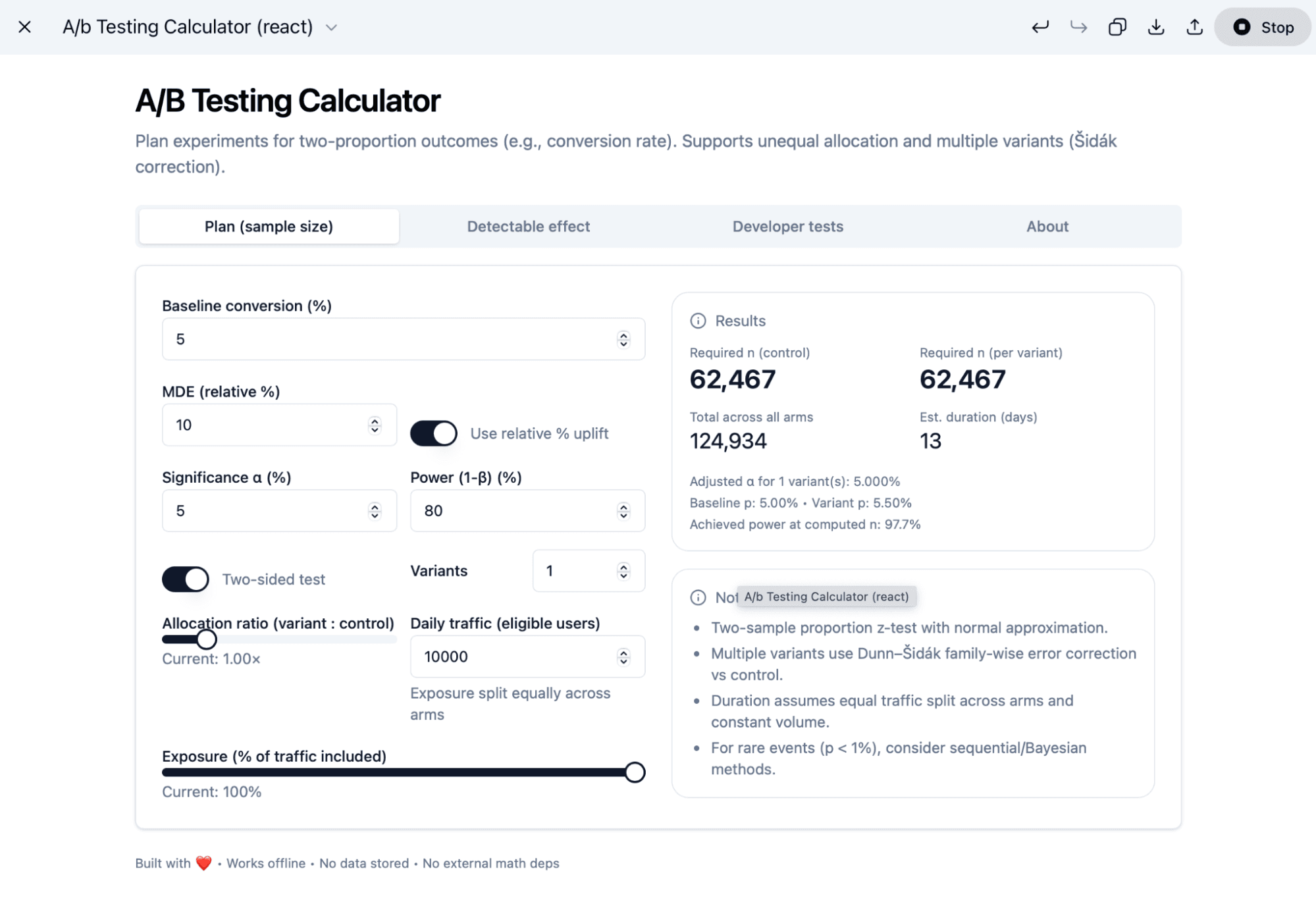

In fact, the focus on sample size is so common that you can even ask ChatGPT to build an A/B testing calculator for you, and it’ll come up with the same formula. Here’s an A/B testing calculator I built in one shot with ChatGPT 5:
A testing calculator built in ChatGPT, with the described inputs and outputs from the article
And because these calculators are so widespread, it’s easy to ignore a simple truth about them: they’re fundamentally misaligned with how experimenters should be working. They fail to prioritize constraints, and they don’t focus on the actual job to be done for the person running the test. So why do we keep using them?
I believe the industry is overlooking what product managers and experimenters truly need: not a sample size calculator with a single answer, but an MDE calculator with a range of results over time.
