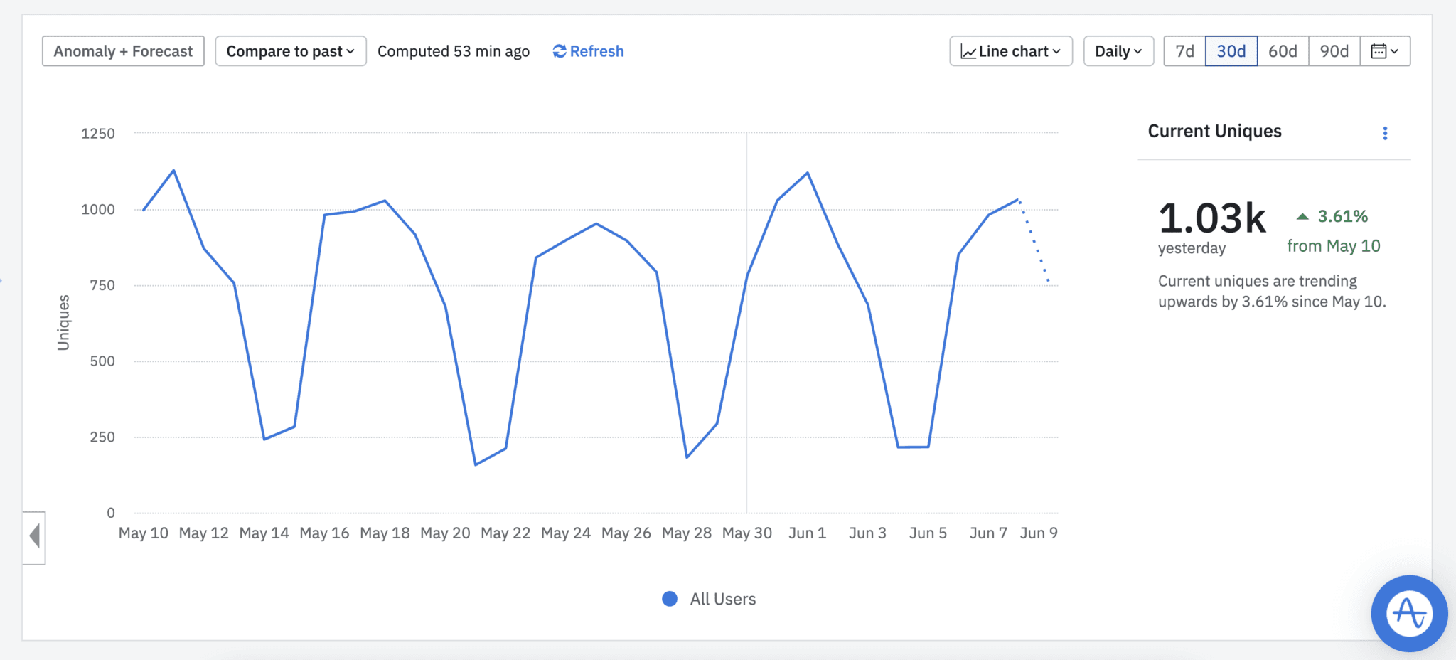

Seasonality
By seasonality, we mean variations at regular intervals. Seasonality does not have to be over a very long interval like a month. It could be even at the day of the week level. Depending on the product, the users who use the product on the weekend may be different from the people who use the product on weekdays. An example is for a maps engine, where on the weekdays, people may be searching more for addresses versus on the weekend, people may be searching more for restaurants. It is possible that the users that get treated on the weekday have a positive lift and users that get treated on a weekend have a negative lift or vice versa.
The question you need to ask here is if the T-test says to run for 1 week and the sequential test reaches statistical significance after 4 days, would you really stop at 4 days? Here it would be better to run a T-test if you believe there is a day of week effect. If you stopped after 4 days, you are making the assumption that the date you got in those 4 days is representative of the data you would have seen if you ran the experiment for a week or two weeks.
Generally, you want to run experiments for an integer number of business cycles. If you do not, then you may be overweighting on certain days. For example, if you start an experiment on Monday and run it for 10 days, then you are giving data on a Monday a weight of 2/10, but a weight of 1/10 for data on Sunday. As you run the experiment for longer, the day of the week effect decreases. This is one of the reasons you may see the general rule of thumb at your company of running an experiment for 2 weeks.
Here is an example of a chart with seasonality.
