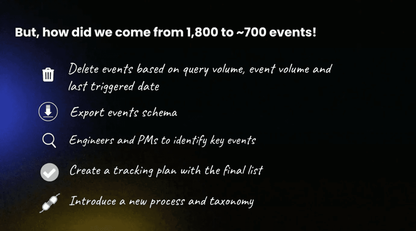

How we solved the problem
Explanation of reducing 1,800 events to 700 by deleting events based on query volume, exporting event schema, identifying key events, creating a tracking plan, and introducing a new process and taxonomy
Step one: Delete unused events
First, we identified events that weren’t being used recently or often by looking at the query volume, event volume, and last triggered date metadata available to us in Amplitude.
We also worked directly with the Amplitude team (huge thank you to them!) on a deep clean that brought our event count down from 1,860 to around 1,100.
Step two: Export and analyze
We exported the full event schema to get a complete picture of what we were working with. This became our master document for the cleanup process.
Step three: Identify key events
Next, we went team by team, working with engineers and product managers to identify which remaining events were actually crucial for their work. I won’t sugar-coat it—this was tedious. You have to chase people down and really push for answers, but it’s essential for understanding what’s truly valuable.
Step four: Create the tracking plan
With our final list of validated events, we created a tracking plan in Segment. This became our single source of truth for what events should be allowed through.

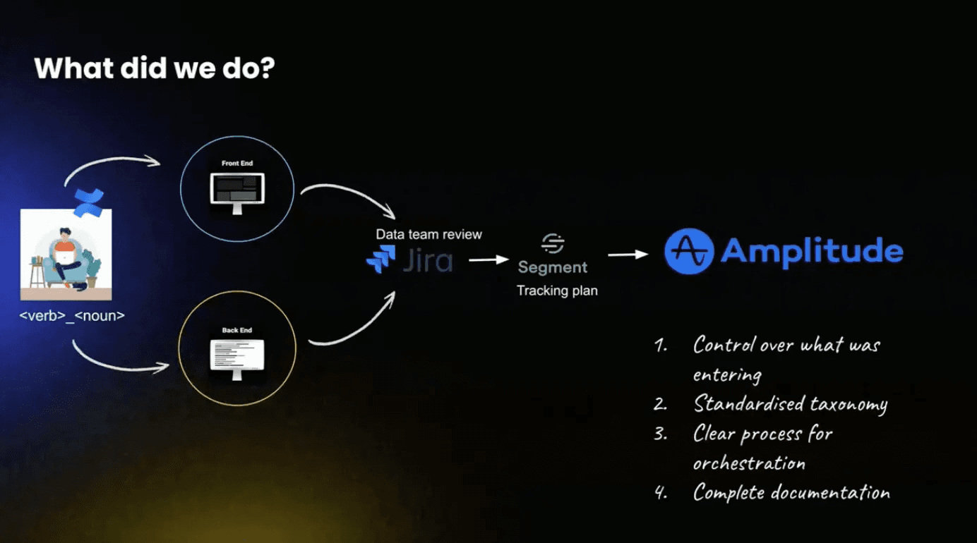

Step five: Implement new process and taxonomy
This is where the real transformation happened, though it could not have started without first doing everything else. To go fast, you must first go slow.
Flow chart showing solution for controlling events, standardizing taxonomy, creating a clear process for orchestration, and making complete documentation.
The new process looks like this:
  • Engineers can create events from either frontend or backend systems
  • But before any event reaches Amplitude, it must:
    • Go through a data team review in Jira
    • Pass through Segment’s tracking plan
    • Meet our new taxonomy standards
This new system gives us four key benefits:
  1. Complete control over what enters our analytics environment
  2. A standardized taxonomy that everyone follows
  3. A clear process for event orchestration
  4. Proper documentation at every step
The game-changer was using Segment’s tracking plan as an enforcement point. Any event not in the tracking plan gets automatically blocked and diverted to a separate warehouse. This creates a natural feedback loop—teams quickly learn to follow the process when they see their events aren‘t showing up in Amplitude.
Is it more time-consuming up front? Yes. But that extra time investment prevents the much larger time sink of dealing with thousands of poorly tracked events down the road.

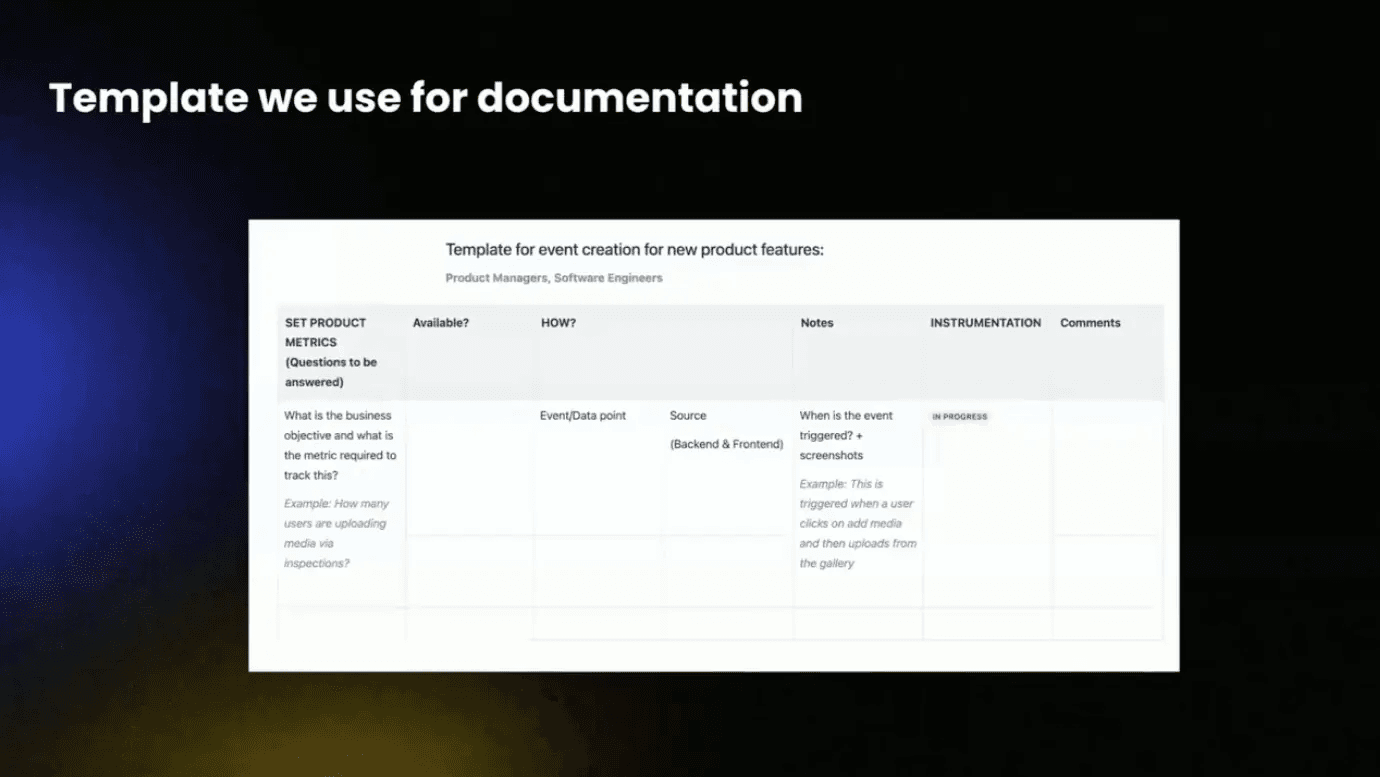

In case helpful, here’s the template we use for documentation:
Template for event creation for new product features used by SafetyCulture
