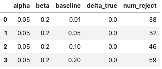

Within the example, p-values fluctuate, even before the end of the test when you have reached 10,000 visitors. By peeking, you are inflating the number of false positives. The table below summarizes the number of rejections for different configurations of the experiment when running a T-test.
Table describing fluctuations in p-values with the num-reject numbers movoving from 38-59 to signify a fluctuation in p-values.
Here, baseline is the conversion rate of the control variant, and delta_true is the absolute difference between the treatment and the control. Since this is an A/A test, there is no difference. With alpha set to 0.05, the number of rejections far exceeds that of the threshold that's set for Type 1 error if we peek at our results—num_reject should never be higher than 5 in this example.

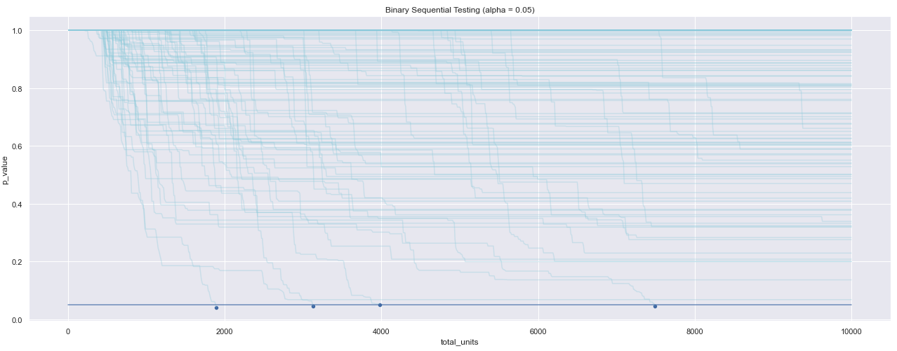

Now compare that to a sequential testing approach. Again, there are 100 A/A tests, and alpha is set to 0.05. Peeking at the results on a regular interval and if the p-value goes below alpha, you can conclude that the test has reached statistical significance. As a result of using this statistical method, the number of false positives stays below this threshold:
Graph of a sequential testing approach. Describes the results of 100 A/A tests over time. Because the p-values goes below alpha, the test reaches statistical significance.
With always-valid results, you can end the test any time the p-value goes below the threshold. From 100 trials where alpha = 0.05, the number of those that fall below four, so Type 1 errors are still controlled.
